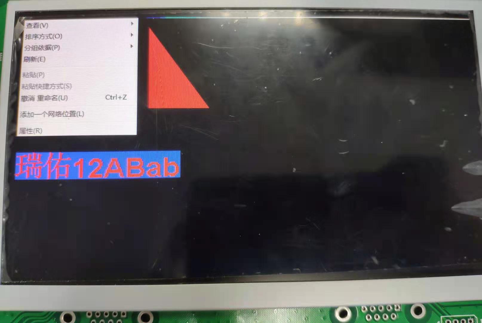

测试效果:
1:默认值
HSCAN_L_to_R();   //左到右
      VSCAN_T_to_B();   //上到下
  2:左右镜像
       HSCAN_R_to_L();   //右到左

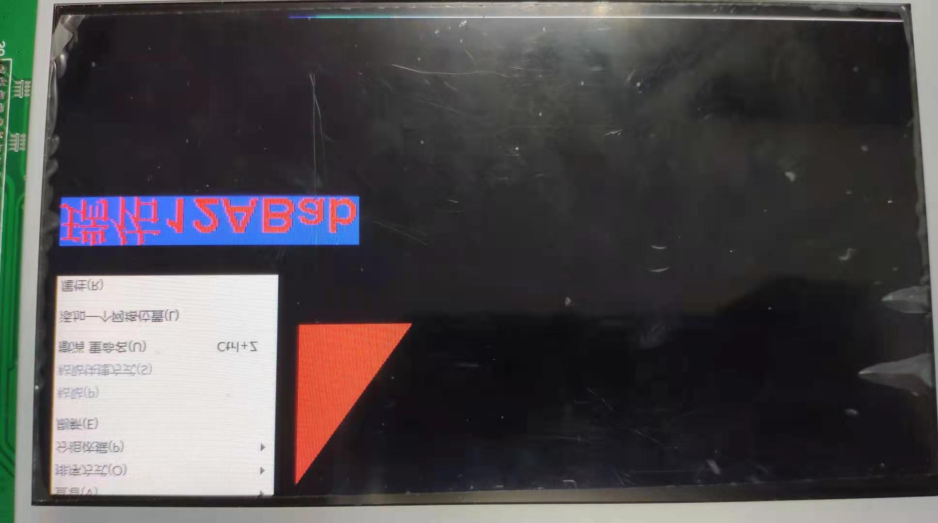

  3:上下镜像
       VSCAN_B_to_T();  //下到上

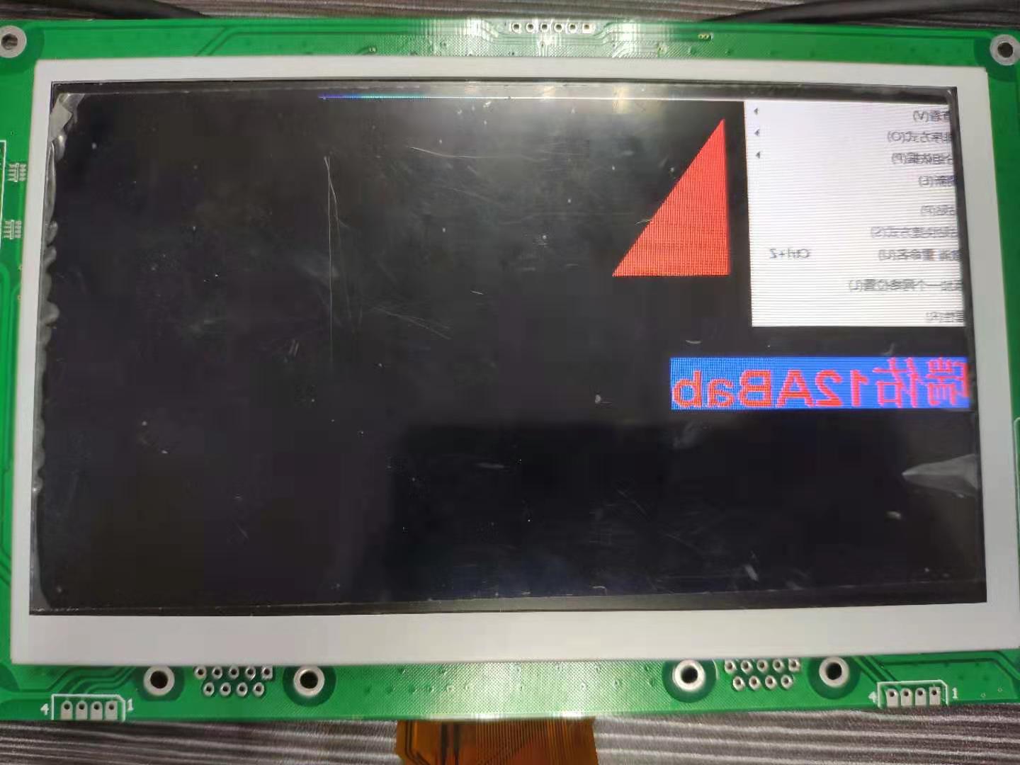

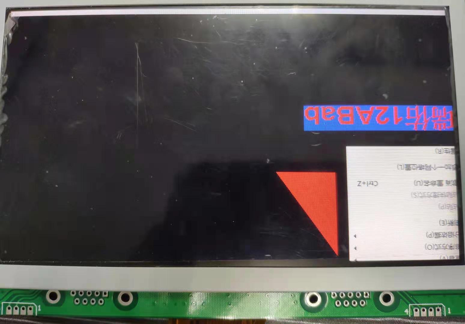

  4:左右镜像
       上下镜像
       HSCAN_R_to_L();
       VSCAN_B_to_T();

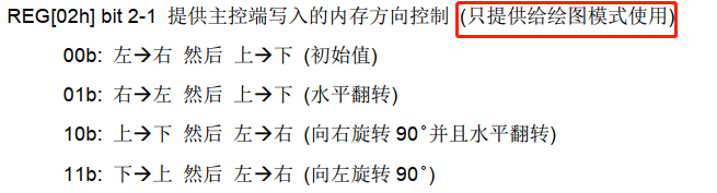

二、旋转
   **寄存器:REG[02h] bit 2-1  **
API函数:
       MemWrite_Left_Right_Top_Down();  //从左到右上到下
       MemWrite_Right_Left_Top_Down();  //从右到左上到下
       MemWrite_Top_Down_Left_Right();  //从上到下左到右
       MemWrite_Down_Top_Left_Right();  //从下到上左到右
测试函数:
       MPU8_24bpp_Memory_Write (0,0,128,128 ,gImage_24);
       MPU8_24bpp_Memory_Write (200,0,128,128,gImage_24);
测试效果:

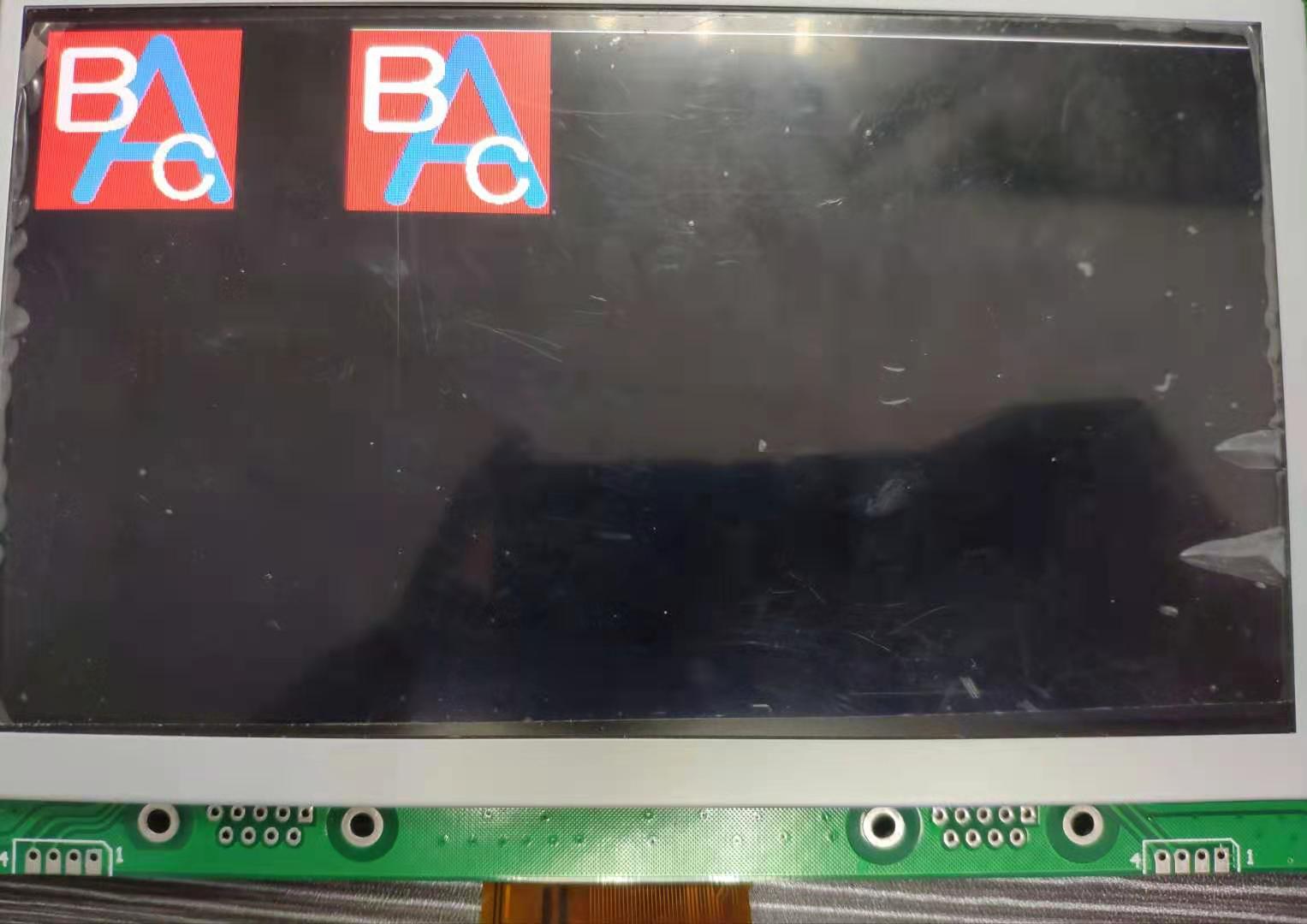

    1:(默认值)
    2:水平翻转

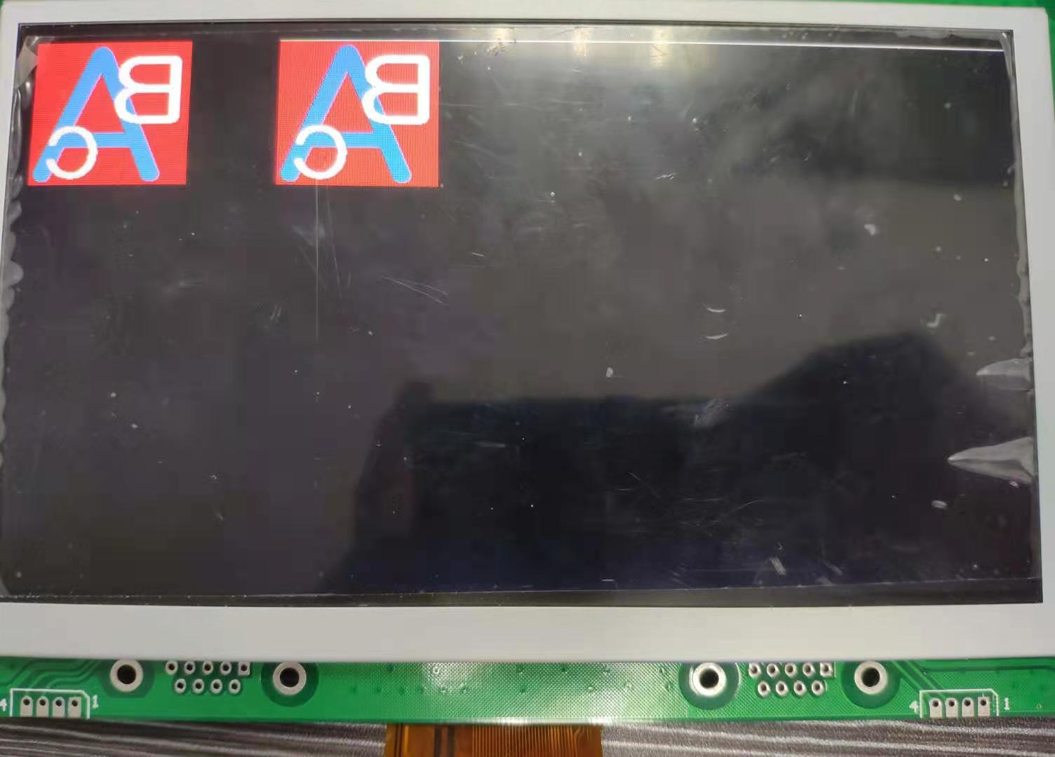

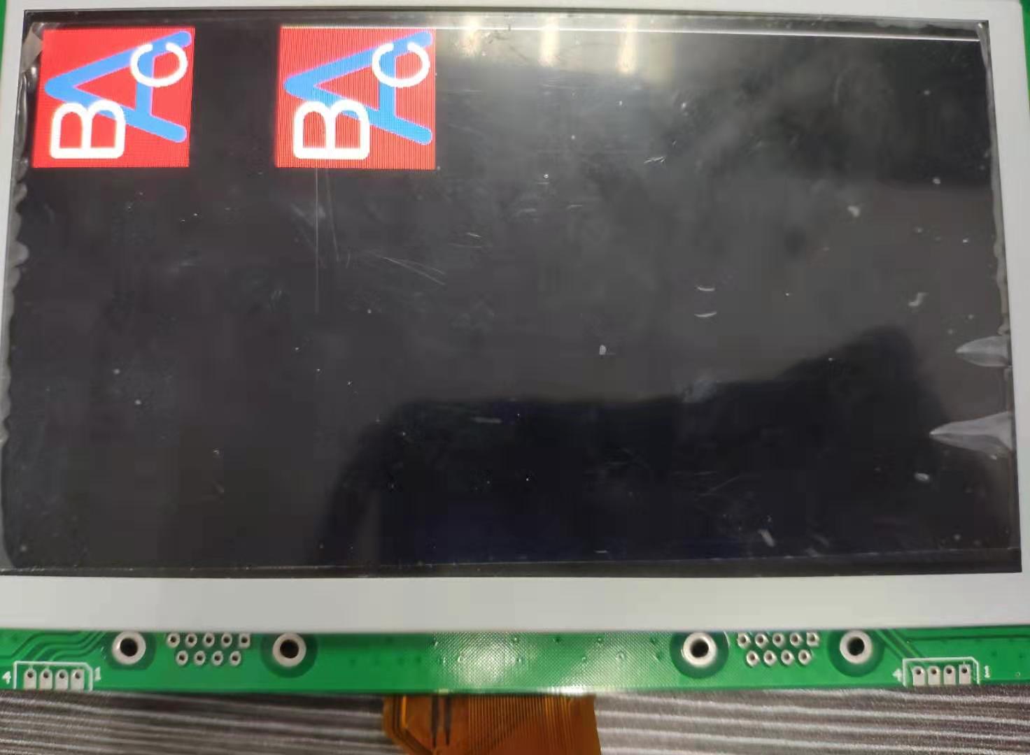

   3:向右旋转 90°并且水平翻转

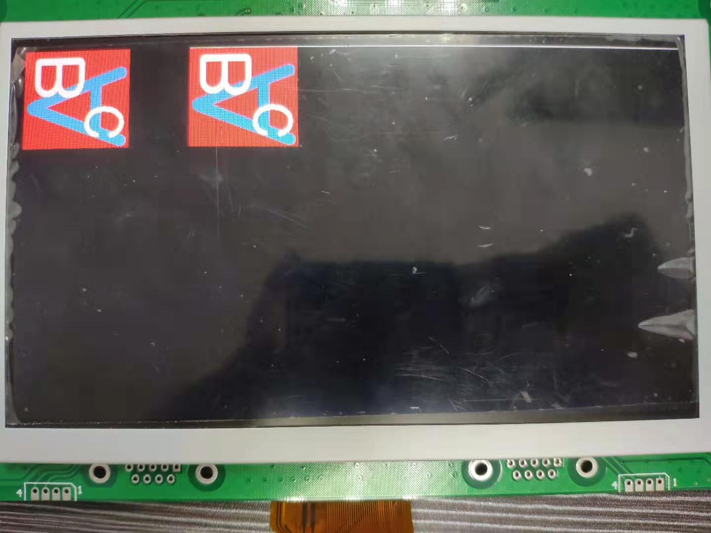

    4:向左旋转90°
